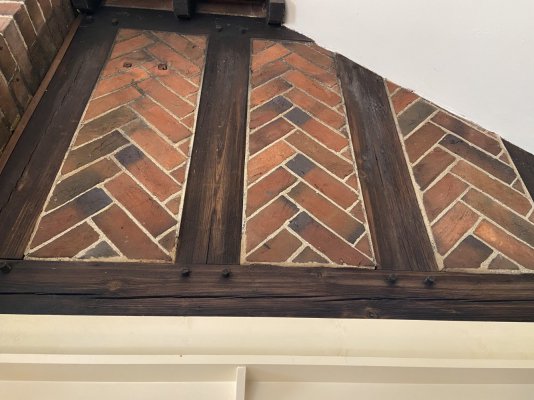

I’ve just bought this property and need to re stain or paint this timber. I want to do this properly, so does anyone that can. Advise me on this. I would be very grateful

Mmm... softwood ?
Is that a structural frame or an applique?
In our previous house I used to creosote our decorative softwood... 30 years... and it was already 60 years old... but that was when one could get proper creosote from the hardware store and didn't have to buy it in 5 gallons online.
Toby is the guru round here, but if you want to do ... something... I use a 50/50 of boiled linseed and turps for external wood. The turps helps it penetrate. Prevents wood from getting too soggy.
In view of Toby's observations I shall upgrade from linseed to Tung oil.
Real turpentine, btw, you can get in gallons on't internet. I don't use Turps Substitute.

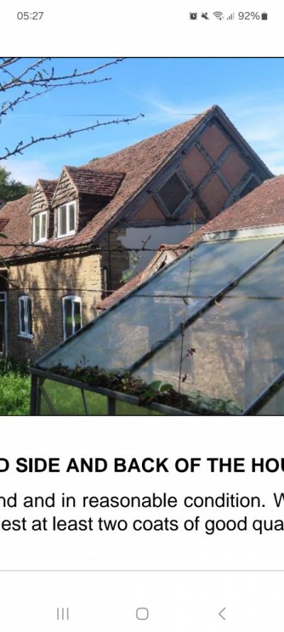

Looks lovely btw.Hi, I'm new here and hope it's OK to add my query to the thread. I've found the above comments really helpful for my situation. I've bought a period property that needs a lot of renovation. It is c.17th century, timber frame but only exposed in a few areas. Main area I'm concerned about is the East facing gable wall. Surveyor advised treating with 'linseed oil or similar'. Based on the above I'm more inclined to use a Solvent based stain. I think something like the below is correct but conscious it's easy to do damage applying the wrong product.
Sikkens Cetol HLS Plus | Sikkens HLS Plus Exterior Woodstain
Buy Sikkens Cetol HLS Plus. A high quality, exterior low build base coat and wood stain. Resists UV light, mould, algae, peeling and cracking.www.wood-finishes-direct.com
Any other advice would be much appreciated. Pic extract from survey.

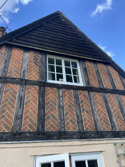

Looks like the beautiful gable end is quite perished, clear off the last vestiges of old stain with a tungsten carbide scraper and a wire brush, depending on how friable a bronze liming brush can be more gentle, but these wear out faster. For stubborn areas use DCM stripper (I use Paramose) and wire clean and wash. A pre sand with P80 can be helpful. Intercoat sanding can be done with P240 or with P150 if you are careful, it's easy to burn through on uneven timber. I would use the Sikkens two stage system as instructed.
