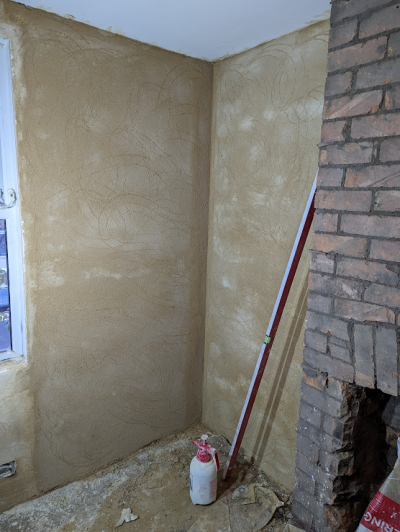

We recently bought a terraced victorian house and started renovating one of the bedrooms. After educating myself a little about lime plaster, I decided tackle it myself as house is relatively small and I'd only replace it on external walls which are mostly susceptible to damp problems. I'm quite happy with the results so far - it's definitely far from perfect, but as an amateur I do think it's decent enough. I finished float coat, and next week I'll be doing the top coat. So far I mixed my own plaster in ratio of 1 : 2.5 of hydrated non hydraulic lime to sand.

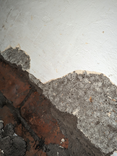

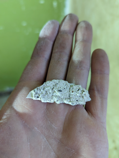

2. Internal solid walls are plastered with original black ash lime plaster, however with my lack of knowledge I can't identify if a finish coat is made of lime or gypseum? I would like to keep them as they are, just refresh it with a coat of either gypseum or lime top coat. My decision which one to choose would be based on what material is it. If it's gypseum, putting lime top coat wouldn't make sense as it's not breathable anyway, but if it's lime, I can finish whole room in lime top coat for more homogeneous finish. I'm gonna attach a photo, hopefully somebody could help me with it.
