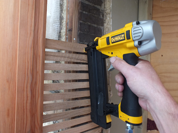

............. an air powered stapler for securing plastering lath? The thought of lots of lath nailing is not filling me with joy!

assuming the stainless is the softer more expensive more corrosion resistant 300 series and not the more usual harder 400 series used in fixings and that the firing pin of the pneumatic gun was some super hard exotic stainless alloy and not tempered hardened tool steel which might leave ferrous particles on the stainless surface thereby seeding corrosion in the caustic lime environment you might be onto something.
as it is I would of thought zinc galvanic steel staples would be better than stainless (theoretically speaking) if staples were a good idea in the first place.

Did I mention Zinc galvanised clout nails and patience already? I did. Sorry.
