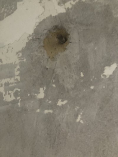

We've taken off the paper in the front part of the building and the walls seem to be cemented inside - but I think there is lime under some of them, and more sandy yellow in other places. But if anyone knows what this grey matter is all over the walls it would be useful - don't know whether to chip away at it and see if the lime behind is salvageable or just take it all off and start again.

The back part of the building the walls are completely flat, the front part is classic regency blockwork though flat at floor level - have attached a few photos.
