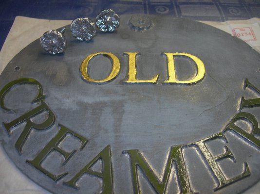

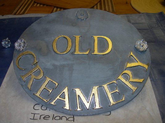

Im sure that many of you can gild so please bear with me, this is how I did it
Here's the kit that is needed, at least what I need for gilding.The only thing not in the picture because I didn't use it (and I forgot!) is the Whiting Powder which is used to protect areas where gilding is not required and the gold sheet won't adhere where the powder is.
There's a pad ( I've forgotten it's proper name!) with a wind shield to stop the leaf blowing away, which can happen even walking or moving quickly, and for cutting the leaf on. My knife has gone a bit rusty (like me) and a brush for picking up the leaf to put it in the required place. This brush works by being drawn across the forehead and then it's either the static or natural oils that attract the leaf to the bristles. I'm not sure which but it works
. To the left is a brush bath and on the right is a tin of gold size (we used to call it mordant once) which is applied to the areas to be gilded.
The whiting is in the chocolate tin. Hint to Santa there.
