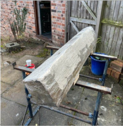

Just though I'd post up results of using Klingstrip to get patchy paint off an Ebay find stone cill - I wanted a suitably weathered cill to replace one that some heathen smashed out of my kitchen, when they wanted the cill to be higher to put a worktop across. They also junked the Victorian arch topped sash and put a crappy softwood casement window in, at some point in the 80's I'd say.
This was the state of patient - this remaining paint was well stuck on, the cill is laying at an angle on it's back here:-
Klingstrip applied:-
And wrapped up in clingfilm:-

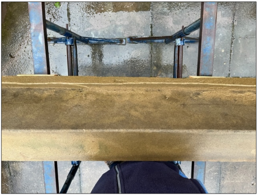

Left for 48 hours, then unwrapped, most of the klingstrip taken off with a blunt scraper, the residue then briefly attacked with hot water and a scrubbing brush prior to a final wash off with a pressure washer. The pressure was turned down to minimum for this - the sandstone is soft, the pressure washer can etch into it very easily.
Here's the end result:-
It's done a really good job I think. I suspect the colour will even out a bit when it's dry, no danger of that here today!
