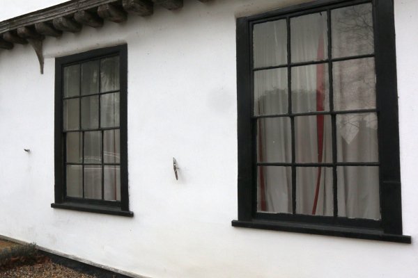

Did Georgian windows ever have shutters on the outside?
The reason I ask is that I have always assumed that my house did not have shutters. The windows are set on the inner skin of 9 inch brickwork so there can be nowhere for the internal shutters to fold up into.
