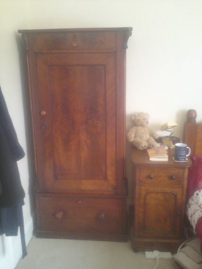

Hello people. I'd be grateful for some help. I recently and rather impulsively bought this small wardrobe. I jumped at it as it was the only thing I've found that is the right size. However It has been messed about with a lot. The top and base are not a match for starters. Also the vertical beading and corbels on the chamfered corners are very rough and the top is not original. The drawer at the top seems a match for the carcass and for the door but the runners and divide between the door and drawer are a later addition/repair and not very well done, especially as the front of the horizontal divide is stained pine and not mahogany veneer. The sides of the main section don't look like they have been cut though so perhaps it is its original height. The panels at the back are nailed to the carcass at the bottom, but not at the top leaving the whole thing a bit rickety, and there is no bracing at the top to nail the back panels into, just the top, so it has been butchered quite a lot (the base is dovetailed into the sides and is quite rigid). I wonder if the drawer would originally have been at the bottom, i. e. the piece is sitting upside down. And I can't really work out where the drawer would have sat unless the door and drawer had no divide between them as there would not be room for one. With a plinth and a cornice, the upper section alone would look ok. I know I want to sort it out and make a better piece, preferably by using the top part as the door and drawer are quite nice, but I don't really know how best to do it.
