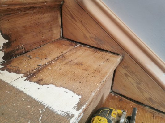

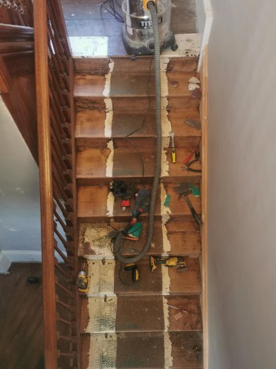

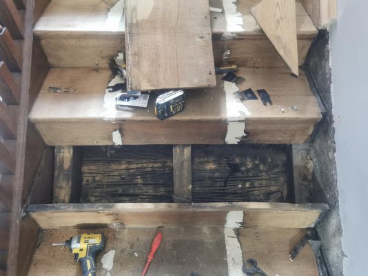

I'm doing some work on our main staircase which will also probably extend to the ground and first floor hall/landing areas (all oak). The floors and staircase treads/risers have all been finished differently over the years so whatever I do I would like to be consistent and choose the right product. The staircase was painted but I've cleaned off the worst of the paint with a view to finishing and installing a runner. Before I get there I have a tread to repair that has split end to end. Unfortunately, there is no access from below but the construction of the staircase suggests that I can remove a section of the string to access the tread in question (I don't think this is actually a string similar to a newer staircase but just looks like one). Has anyone else any experience dealing with old treads in this way?

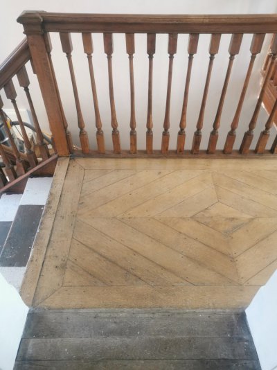

At present, I have a landing that was heavily sanded sometime after the 80s and a varnish (possibly water based as it's very clear). This is the worst of the floor areas condition-wise with gaps, splits and holes. The colour match is really poor with the banister and while I'm not a big fan of the varnish applied to the banisters, I'm in no position to put the work into refinishing that just yet -. Maybe next year! The landing needs sanding then it's a matter of what finish to choose. The ground floor has an older form of finish which is darker but not in great condition.
