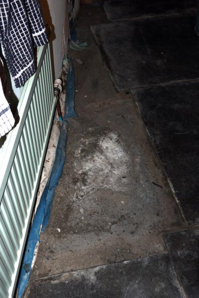

We moved into our 1850 property three months ago. When we moved in we noticed some 'damp' patches on various spots on the flagstone flooring (which is in the lounge and follows into the kitchen, about 30m sq in total). The flagstones aren't in great condition, the 'grout' between them is worn away in places.

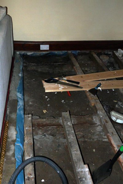

Part of the lounge is joists and floorboards with carpet on top, this meets the flagstones about a quarter way into the room.Today we have taken up the floorboards as my husband put his foot through one whilst looking for something behind the sofa! Several of the joists and floorboards have old woodworm and so we will replace these.

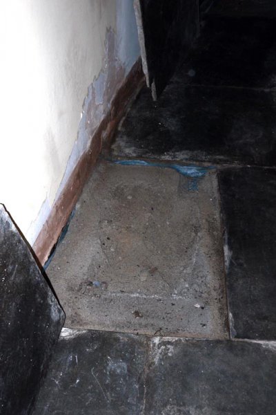

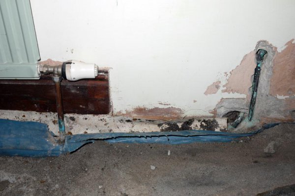

Having taken up the floorboards we have had our first chance to look at what the flagstones at laid on. There is 'earth', with a blue plastic sheeting dpc, then a layer of concrete about 1-2 inches deep followed by the flagstones, which are about an inch thick.
The concrete between the dpc and the flagstones is crumbly and damp. You can crumble a piece in your hand and it will leave you hand quite wet.
Im wondering whether moisture from day to day living has soaked into the flagstones and down into the concrete causing it to crumble or the dpc could be 'sweating'. Or I suppose there could be a leaky pipe buried in the concrete layer somewhere.
Does anybody have any useful advice? We are thinking that the flagstones need to be lifted, a new dpc, or not? New concrete bases and then flagstones relaid.
