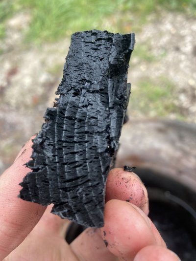

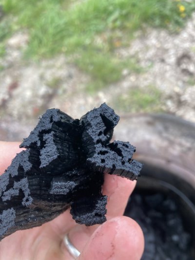

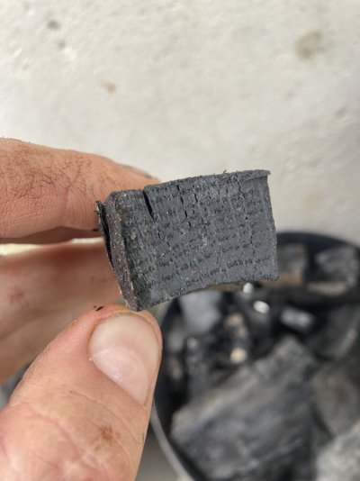

1. Its low density / high porosity (google images of Biochar under microscope) which should trap lots of air and make a good insulation.

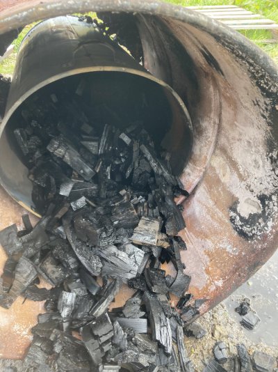

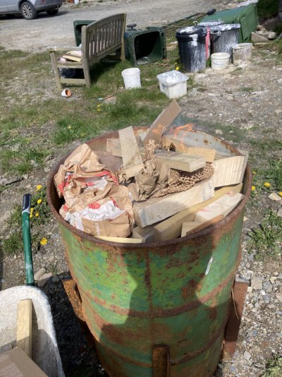

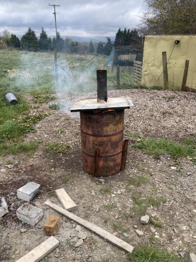

4. Its locality, accessibility and affordability (it can be manufactured at backyard scales from waste-stream woods that can often be freely or very cheaply obtained).
5. It’s non-toxicity (assuming you manufacture it from clean, untreated wood) and sustainability (it locks up carbon into the stable plaster like all bio-aggregates and can go right into the garden at the end of its life).

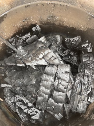

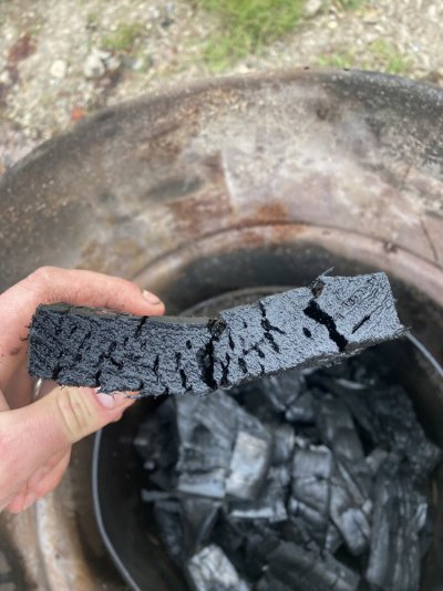

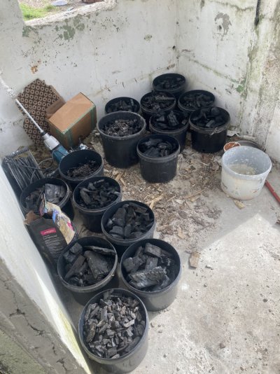

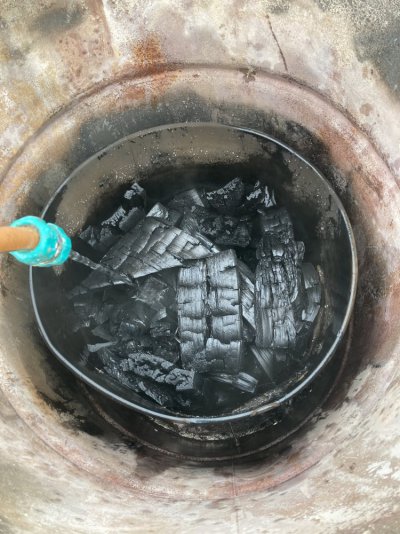

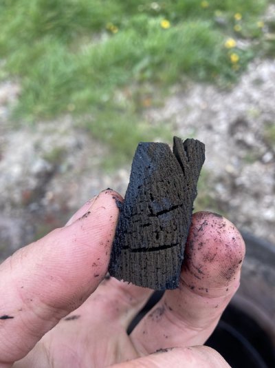

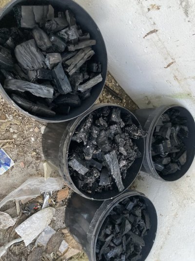

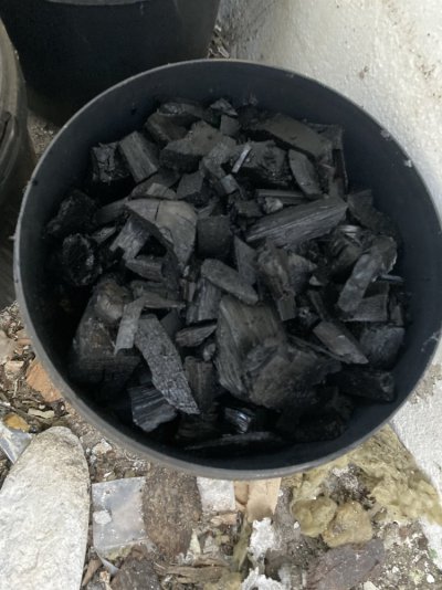

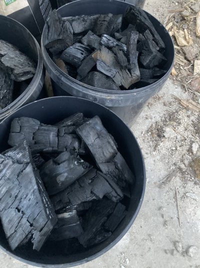

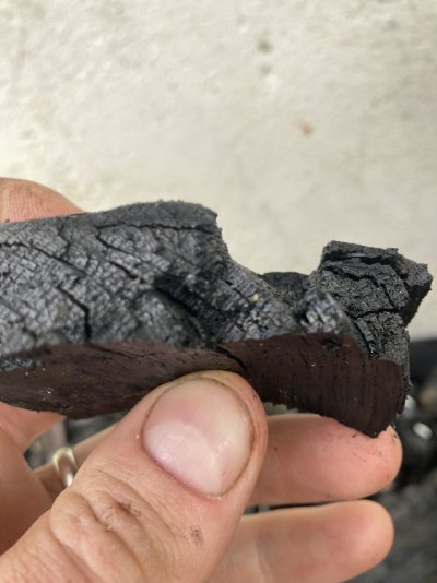

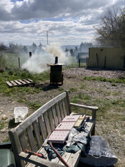

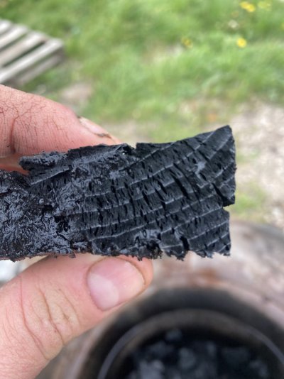

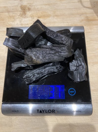

To give this a try I will be manufacturing my own Biochar, crushing it into a medium-grain aggregate and mixing it into a mostly non-hydraulic lime binder. I will then be thickly applying it (4- 6 cm total thickness in 2 or 3 coats) to the interior surface of cold, uninsulated, single-skin modern cement bricks that make up the walls of a small outbuilding which we are converting into a home office.
