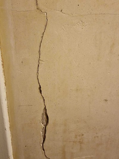

Hi all
First post so please go easy on me!
Intro: I have recently moved into a 1920s sandstone end-of-terrace in Scotland. However it's proving to be slightly more problematic than I first imagined... a common theme on this forum I imagine
So I have a few pretty basic questions that hopefully I can get some guidance on...
First one: what sort of plaster do we think this is? I'm guessing this is lime mixed with animal hair?
I've seen quite a bit of seemingly dogmatic content online about the need to maintain the same plaster, use breathable paint, etc in properties of this age. To what extent is there any scope for pragmatism here? For example, if all walls are covered with PVA and gypsum but the house was otherwise well-ventilated, is this still inevitably going to lead to a bad time? What are the other parameters here? What about internal walls vs exerior-facing walls?
My electrician had brought in local Joe Plasterer to 'make good' the raggles on the wall and I asked him to apply a finishing coat to one small room (I am living in the house while I renovate so the temptation to have at least one habitable, somewhat 'finished' room was strong). However, I later realised that this may have been a mistake given that he has just applied bog standard PVA and gypsum to walls and ceiling. There is one 'exterior' wall in this room, which is 3m high and 2.5m wide with at least 1/3 taken up by a window. Should I, for example, be taking the new plaster back off if I was smart? Or is it unlikely to be a huge problem? What if I wanted to insulate this wall in time?
Potentially related subject... On the same wall, there are two vent holes (approx. 10x10cm) - one at the top and one at the bottom, both of which reveal a small cavity. The top one has a small duct to a vent on the exterior/outside wall. I wonder what the original intended purpose was for these... The other rooms on this floor have fireplaces so I wonder if these were to let fresh air in? Or are these likely to still be required for ventilation?
OK I think that's probably more than enough questions for now
Thanks a lot for reading if you got this far!
