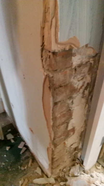

We always assumed the walls are solid, but they vary in thickness from 6 inches (the bay), through to a good 12 inches on the side walls. The slightly earlier house next door is built with stretcher bond, so we wonder if in fact our house has cavity walls? How could we tell?
