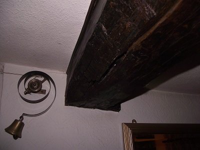

I have a 500hundred year old oak framed cottage and want to know if I can use driven hooks into the main timber? I am presuming it is pretty dense piece of wood and a few hooks won't damage it??

Unless your main timber is incredibly small in section, you won't cause any problems. I presume your driven hooks have square, tapered shanks? If so, drill a hole a bit smaller than the across-flats dimension at the thicker end. When you hammer in the hook, don't be tempted to welly hell out of it - lubricate it (as Philip suggested) by rubbing it against a bar of soap (nothing less than Cussons Imperial Leather will do! :wink: ), insert it into the hole and when you can't push it any more, start to drive it in with your hammer. Use lots of small blows, rather than a few mighty ones!Duchess said:want to know if I can use driven hooks into the main timber?

Penners said:Unless your main timber is incredibly small in section, you won't cause any problems. I presume your driven hooks have square, tapered shanks? If so, drill a hole a bit smaller than the across-flats dimension at the thicker end. When you hammer in the hook, don't be tempted to welly hell out of it - lubricate it (as Philip suggested) by rubbing it against a bar of soap (nothing less than Cussons Imperial Leather will do! :wink: ), insert it into the hole and when you can't push it any more, start to drive it in with your hammer. Use lots of small blows, rather than a few mighty ones!Duchess said:want to know if I can use driven hooks into the main timber?
Just think very carefully about where you insert the hooks, because once they're in, you'll need to tractor to pull them out again!
