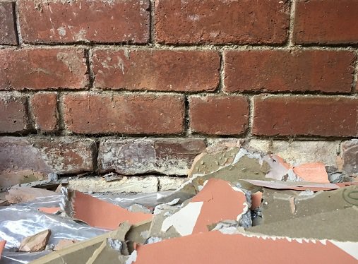

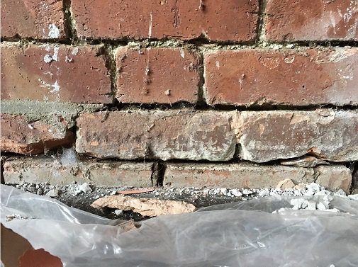

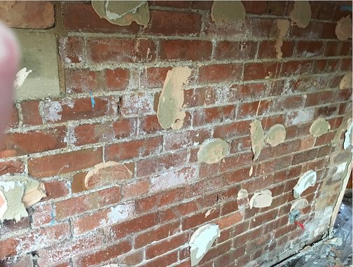

Anyway, I pulled off the plasterboard today on one wall, and was surprised at the sheer amount of salt on this internal wall. I was also concerned that at the bottom of the wall, it seems that a lot of the mortar is missing or has eroded away. The mortar higher up seems ok.
There is also evidence of a DPC having been injected at a lower level just below the floor slab, due to regular drill holes.
I am therefore now wondering what to do, if I am indeed doing the right thing with the membrane, and what I need to do about the gaps in the mortar of the walls. Could this be an issue with cement mortar having been used higher up perhaps? (I dont know that it has, just guessing) instead of lime mortar?
