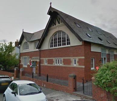

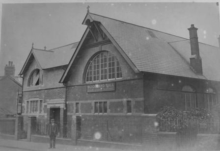

I'm trying to decide on the approach to the render. Likely limewash or silicate paint. The original architect's water colour shows a buff coloured render. We seem to have a sand coloured render under the plastic paint.
The attached is a 1900 photo of a local church hall, designed by the same architect in a v similar style and at the same time. It has the same band of roughcast render over orange brick. Also the hall as it exists today.
Of course, the old photo is black and white... What colour do folks reckon the render in the photo is? :?
