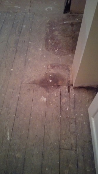

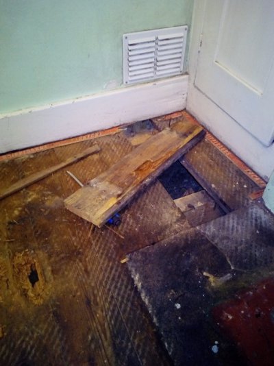

Having lifted the carpet of the old parlour, I was surprised to find the underlay damp to the touch on the underside. The old chimney hearth is visibly wet as are all the floorboards abutting it. Although the floorboards look sound and with no movement (with 1 exception), I lifted one of the boards by the hearth for a closer look and..

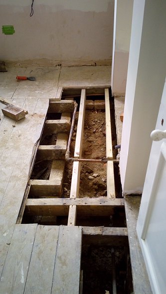

My goodness, there's a strong smell of damp under the floor! It's like a wind tunnel though, so seemingly the underfloor ventilation is working (all the external air bricks are visible and clear). The sub-floor seems to be a concrete base with an inch or so of 'stuff' (soil? dust?) on top.

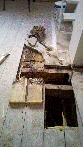

The board I lifted looked fine on top (apart from the damp edge), but was a different story underneath. It looks like woodworm have had a bit of a field day, or maybe it's some form of rot? (Dry to the touch, but powdery). The boards are just under 30mm thick and the damage appears to be limited to the lower 10mm or so of the board. There is some light damage to the top of the joist, but scraping ~3mm of flaky stuff off the top reveals an otherwise sound joist.
With the board up, I can take a closer look at the chimney hearth which is just a concrete hearth on bricks. The bricks and lower part of the concrete are dry to the touch, but the top is definitely wet. I'm a bit puzzled as to how this might be.. is condensation an option?
There was one floorboard visibly springy and I managed to get a screwdriver right through it without any force. I've prodded the top of all the other boards and the underside of all the other boards I can reach from the lifted board and they seem reasonably sound.
Shining a light along the 2 exposed joists, there's no evidence of woodworm or rot visible in the section I can see. So..
Plan A was going to be to lay ply over the existing floor and tile on top. But in light of my findings, I'm wondering whether it's worth removing the hearth entirely? The floor boards are T&G and I'm in 2 minds whether to take them all up, and just put ply straight onto the existing joists (assuming they look ok when they're exposed). Opinions would be most welcome!
