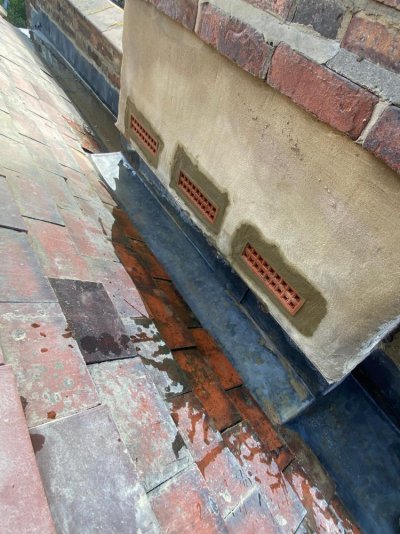

We originally had a lead valley replaced, between the roof and parapet wall.

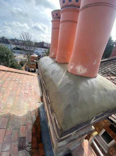

We've since had the parapet wall and chimney breast repointed. And most recently we've had the pots re-flaunched, as well as some air bricks install (as they are no longer working chimneys).

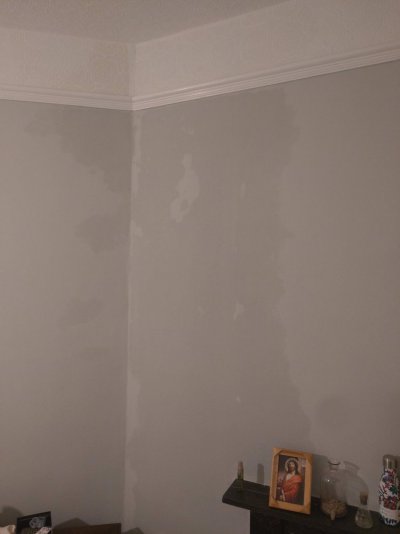

The pots were flaunched about 5 weeks ago. I have a pinless moisture meter and a dehumidifier. The dehumidifier has been running and probably taken 30 litres of water out. Up until 26 April the readings from the damp meter were down from 100 to around 80-90. The dehumidifier was running but was collecting less and less water.
On the 27th the damp patches became slightly more prominent and so I took fresh readings and annoyingly we were back up to 100. There probably was a bit of rain overnight on the 26/27th. But we also had some new radiators put in downstairs on the 27th and I cranked the heating for a few hours to test those (and because the floorboards were up it was cold anyway).
I put the dehumidifier back on and it's been running for 24hours and collected 3-4litres of water again. The surface readings are again back to around 80-90.
That's an awful lot of waffle but wanted to give some background and the fairly simple question is how long might we expect for this to dry out, brick, lime plaster and papered walls AND is it normal for damp to continue to rise to the internal surface.
Could the higher readings have been explained by the heating on and the damp being drawn to the surface or might it indicate the underlying issue has still not been resolved?
