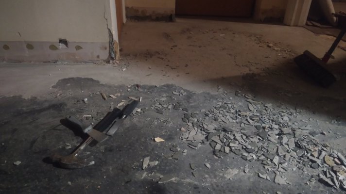

More info required - age, construction of house, why you’re removing the concrete…I'm trying to remove a layer of concrete from a bitumen covered floor. I'm chipping away using a chisel and hammer but making very slow progress. I don't want to damage the bitumen underneath as I assume it's there as a DPM. Can anyone recommend a better way to chip it away?
The cottage is c1800 at the front, and about 30 years old at the back. It's constructed of mainly brick and some stone. The part in the photo, the hallway, bridges the old and new part. The old part of the house has thick bitumen covering the floor (under which is concrete in one room and a brick floor laid directly onto earth in the other). I assume the bitumen was laid later in these two rooms as DPM. The newer part of the house has concrete floors, no bitumen (I assume a DPM was laid underneath the concrete). The hallway in the photo I thought was part of the newer build, but maybe it's on an old footprint hence the bitumen. Under the bitumen is concrete (I broke a hole in the bitumen to see if there might be an original floor of some kind, alas not). The hall floor was covered in very thin vinyl laminate flooring. When I removed it there was this thin layer of concrete under the laminate, over the bitumen (perhaps laid to help the glue for the laminate floor to stick, as don't think all glues stick to laminate). I am planning to lay limestone floor tiles in the hall but there is very little room below the doors for them doors to open, so every mm counts. Removing the couple of mm of this concrete covering is the difference between laying the floor I want and the doors still being able to function, or having to mess around with doors, frames, etc to make them fit a new floor height. I was assuming the bitumen needs to stay but would be happy to remove if not needed... Any advice appreciated. ThanksMore info required - age, construction of house, why you’re removing the concrete…
