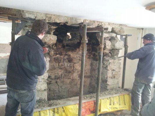

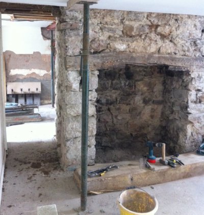

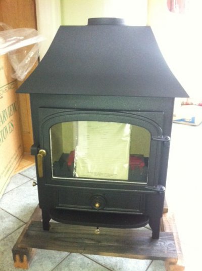

P Phill123 Member Messages 24 Jun 11, 2013 #1 Following a visit to Dinham House in Ludlow, we have just ordered a Clearview Vision 500 Log Burner with a Low Canopy Just in the process or re-pointing and replacing the beam with a a new oak beam. Will upload pics upon completiton! Attachments Cottage.jpg 168.9 KB · Views: 369
T TheForge Member Messages 306 Location Somerset Jun 11, 2013 #2 Is that a lintel that's been cut off over the doorway opening? Is there any masonry above that opening and if there is what's supporting it? The masonry above the fireplace lintel looks pretty unstable too, replacing that lintel is going to be tricky.
88v8 Member Messages 3,131 Location Glorious Gloucs Jun 12, 2013 #3 Phill123 said: Following a visit to Dinham House in Ludlow, we have just ordered a Clearview Vision 500 Log Burner with a Low Canopy Click to expand... Great stove. We have one with a flat top. Can boil kettles, heat soup... Ivor

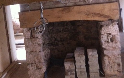

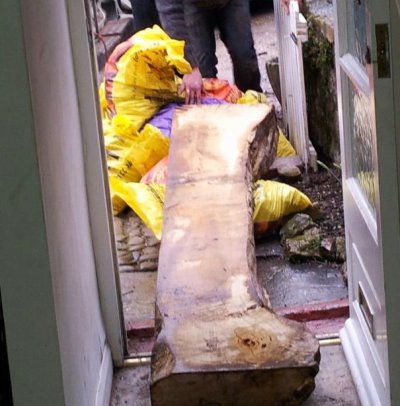

P Phill123 Member Messages 24 Jun 14, 2013 #4 The original Lintel had been cut ! Which is a shame as we would have kept it in.. This and that fact it was full of woodworm prompted us to change it. Ive attached some more pics to show recent update. Im still questioning over Slate or Stone Hearth.. Any thoughts?? Attachments Photo 1.JPG 141.2 KB · Views: 257 Photo 5.jpg 116.5 KB · Views: 257 Photo 6.jpg 47.8 KB · Views: 257
P Phill123 Member Messages 24 Jun 14, 2013 #5 Oh yeah Burner arrived today aswell Attachments Photo 4.JPG 78.5 KB · Views: 256
