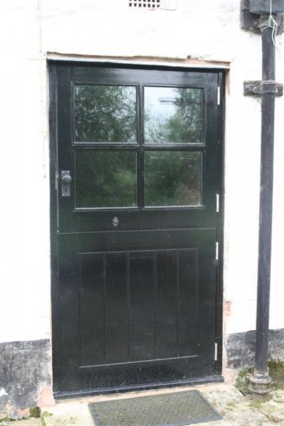

I have talked to my joiner about making external doors for me in the same Douglas Fir that he made my windows in, thicker than the standard door to take 24mm double glazed units, but this is working out a bit expensive.

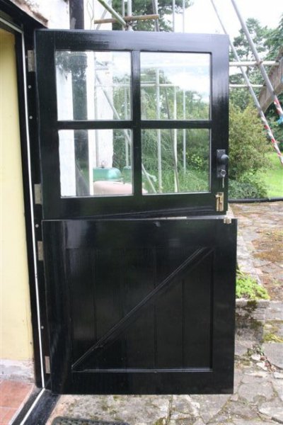

And then there's the style. I would like as much glass as possible to let in light because there aren't many windows in the house. I was thinking stable doors perhaps, with 9 panes on the top, so I could open the top half in the summer, but I don't know if this is a modern fashion and not very traditional at all. I presume anything with that much glass in is not very traditional?
