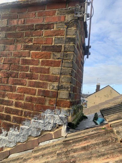

Hello all, I'm new to the forum and to period (and in fact all) property ownership. I've just bought my first house, a mid-terrace Victorian cottage. Unfortunately upon moving in the roof was leaking in the chimney area - I first spotted damp at the top of the chimney breast in the bedroom. I have some quotes for the repair and am discussing with next door neighbour as it's a shared chimney. I just wanted to get some thoughts on a couple of aspects of the chimney... we are looking at getting lead flashing done to the sides and front. The neighbour's builder friend has said the flashing to the rear looks good, however I have some concerns that it appears that there's a block of wood propping up the rear of the chimney?! Also, some "stuff" has been painted on the brick on my side - should I be looking to have anything done about that?
Any advice you can offer would be much appreciated - I'd like to go into this as well informed as possible to make sure the job is done properly! Any tips on where to go to learn more and what to ask for etc.
