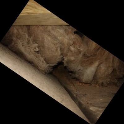

Recently I managed to get a camera up the chimney (GoPros can do anything!) to see that when they took the top off the chimney, it looks as though they simply rolled up some rockwool and stuffed it in the hole and called it a day. hhmmmm.
I am imagining that that might be a bit of a magnet for condensation? Or is that an accepted way to seal a chimney?
I haven't managed to get a camera up the front chimneys, but I have concerns. I mentioned the lack of chimney stacks, I also mentioned the gas fire? Yes it was tested when I moved in, and yes it has been used. State of any rockwool at the top of the chimney... unknown. I tried getting a camera up from the basement fireplace after it was opened up, but they dropped a brick down it when they took the chimney off so I can't get all the way up...
So, TLDR: Rockwool in the top of a chimney - good idea? Or should it be removed somehow?
