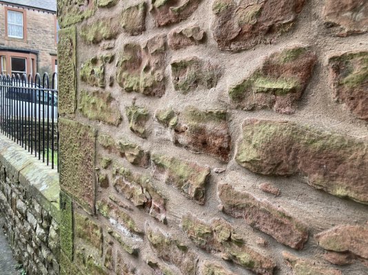

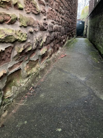

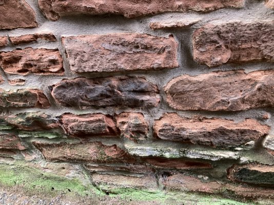

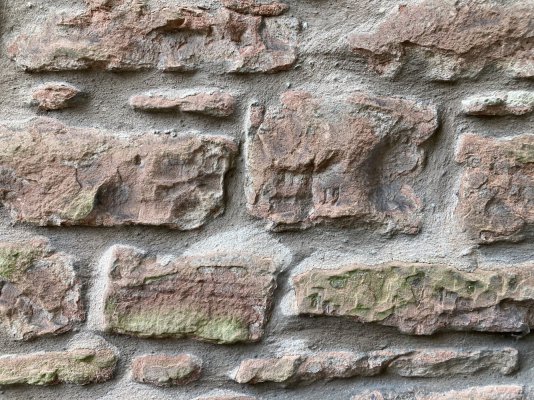

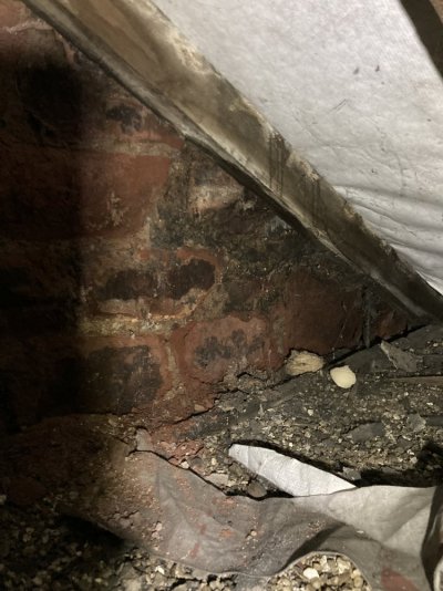

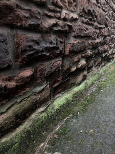

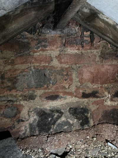

Another new member with what seems to be a perennial problem. So we’ve bought a Victorian sandstone house in Cumbria, the survey did ‘touch’ on the pointing on the gable end, but not in any detail. Over the past two years however, as we’ve been living in, and working on the house as and when time permits, we’ve noticed some damp and mould problems. First I put it down to inadequate heating and condensation; the last owner had a 45yr old Rayburn with a heat output equivalent to a hairdryer, and laughably pathetic radiators; fadt forward and Rayburn is replaced with beefier oil cooker with PJ burners and proper radiators, and we have heat, yay! Problem remains, boo! Having now had a a number of tradesmen around and I have a plethora of diagnoses as to what the problem is, but basically it’s one of two: 1. Lack of insulation, nothing to do with cement pointing, and anyone that says otherwise is basically an evangelical lunatic. 2. It’s the cement pointing and anyone that says otherwise is basically a Neanderthal.
Doing my own research I’m leaning to option 2, minus the judgments. But now I’m in another position: how to deal with it. Everyone I’ve spoken with is booked up for year/s, and had told me I need to pull out the cement pointing ASAP. This seems easier said than done as the pointing is no more than ten years old and rock solid, also it is very liberally applied in places, and this is a very large gable end wall. The damp seems to be most evident in top floor bedroom and rear first floor bedroom (oddly enough front bedroom and living rooms seem fine). Does anyone have any recommendations or suggestions as to how we can most effectively and economically address the problem?
