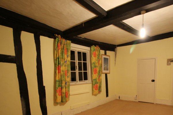

Next question lovely people. The ceiling, lath and plaster, all faily intact, but it has had several coats of something over the life and there are flakes and bubbles. I have scraped with the amazing stanley knife scraper. Under the skim - some has come off an some has not it is sound. My options are to finish the scraping which gets off all the flakes and loose. I could then prime with DG 27 primer and skim heritage plaster over the area- I am not good enough to do that. Or I am thinking of a wash down with sugar soap - I have read the thread, then paint with something that will go over anything, like seciltek?
Others must have had flaky bumpy ceilings, what have you done?
