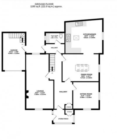

In the floor plan below, the room I’m currently working on is the front right hand side. Directly behind it is the dining room which I’ve now confirmed also has a filled in concrete floor. Behind the dining room is a modern kitchen extension (concrete floor) and directly behind that is the boundary wall. The extension is actually built into this wall.
Although the house is detached, its sits up above some shop units to the right hand side where the tops of their metal roofs sit just above my floor levels.
The central hallway is original quarry tiles on what I presume is a limecrete base.
So this room I’m working on is hemmed in on all sides with solid floors and no way to properly cross ventilate that I can see.
