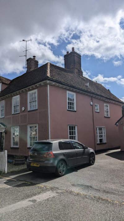

Last year we purchased the below c1500’s semi-detached property.
We had a level 3 survey done and it didn’t flag immediate works but some works that needed doing in 3-5 years. The main two were firstly removing the cement render around the base of the building and replacing with lime. The second was to lay additional felt around the edges of the roof where it had deteriorated/fallen away and put new gutters in to improve drainage.

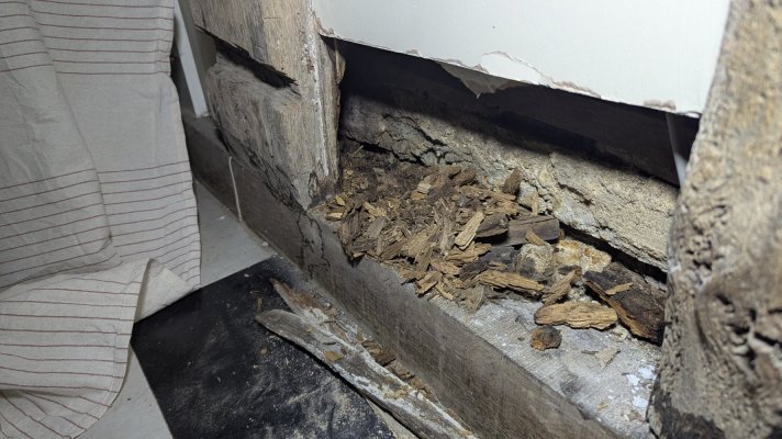

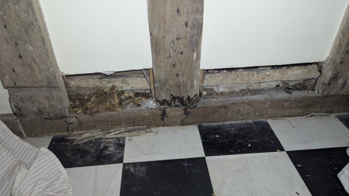

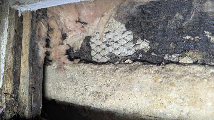

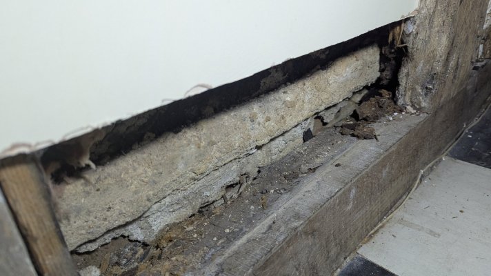

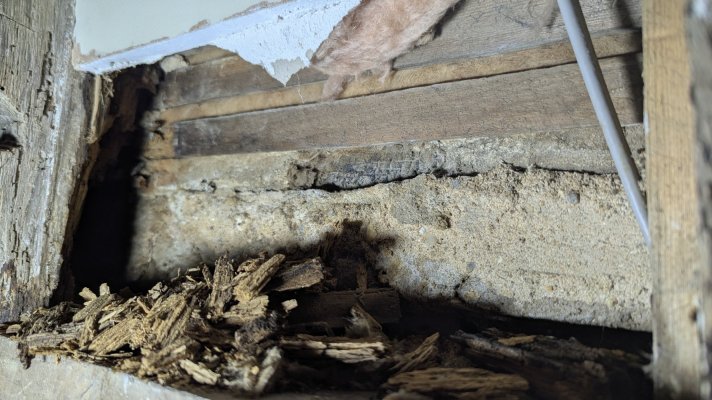

Over the winter I noticed that the plasterboard in the lounge was starting to warp and at one point we had mushrooms growing on the sole plate. I decided to cut some holes in the plasterboard to investigate and was a bit shocked/upset to find completely rotten timber the other side. In parts about 2/3 of the soleplate is gone. There was some form of fibreglass insulation with a foil backing that had soaked up the moisture and it was unable to escape. Since cutting the holes that area has dried out.
