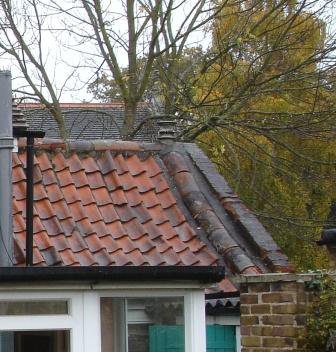

Now that it is rebuilt and almost finished, it turns out that it is much larger and more imposing than the one that was there before. Here's the old one, and the half-finished new one, which still has to have an outer layer of brick next to the blockwork, then a creasing tile and a brick on edge on top of it, so will be even taller and wider than it is now.
