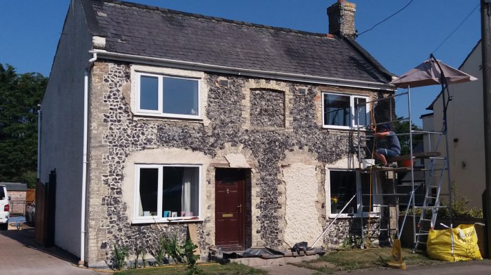

We are restoring our flint home back to how it should be, sadly it was rendered over years ago.
We have removed most the render off the front of the house now, it looks great other then around the windows.

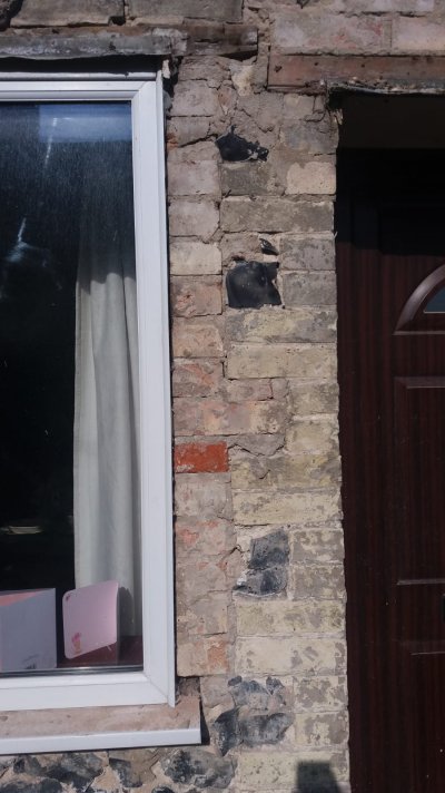

Looks like all the original brick has been removed from around the windows, we have engineering bricks there now which support a wooden beam.
How was the original done, do you think the old frame might have supported the bricks?
