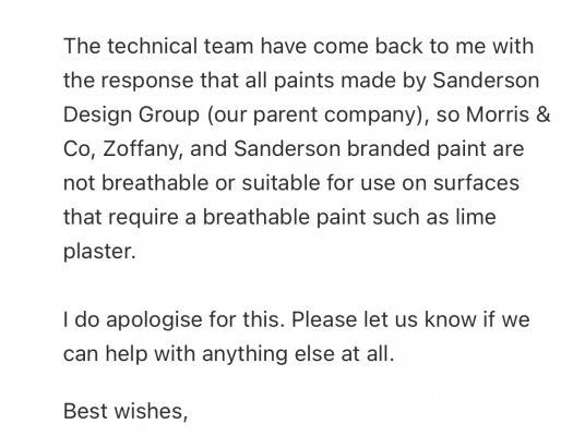

Entirely depends on SD value, nothing was forthcoming on the descriptions on their website so difficult to say if breathable or not.Does anyone know if Morris & Co paints are breathable? Many thanks
