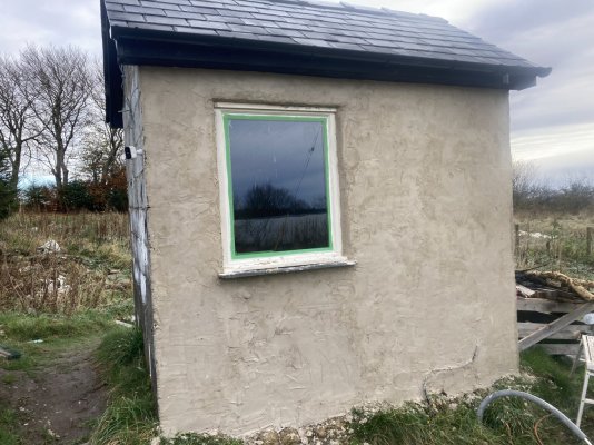

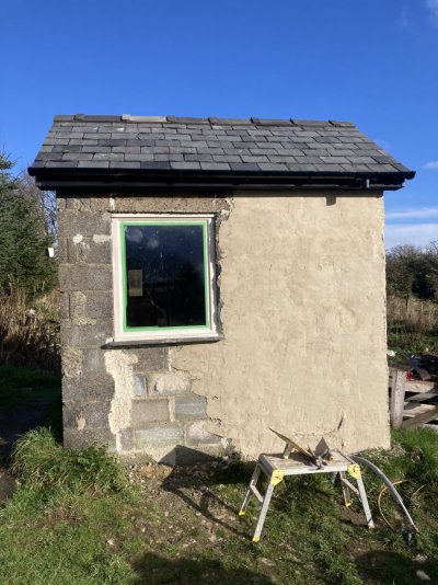

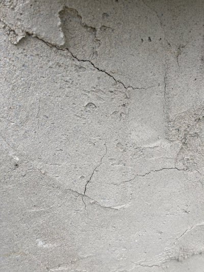

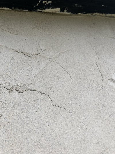

Well I’m going to do it anyways. Scratch coat rendering in -2 degrees. Let’s see what happens…
2 parts washed medium grit sand, 1 part NHL 3.5, plus some sheepswool for fiber. About 1 cm average thickness.
I’ll provide updates over the next few days. Anyone have any predictions as to what will happen? Will it fall off the wall? Crumble into dust at the slightest touch? Crack into a billion sections on the wall?
