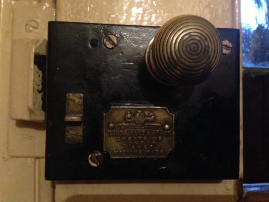

D Dianne Member Messages 50 Apr 8, 2013 #1 About the re-paint the rim locks in my victorian house. They're currently black and I'll keep them black but can anyone advise the best product to use to pain them and should they be painted matt or gloss? Thanks, Dianne
P plasticpigeon Member Messages 2,462 Location Birmingham Apr 8, 2013 #3 Can it be bought though??? It is gloss though.
S Svenedin Member Messages 68 Apr 8, 2013 #4 I used smooth Hammerite when I did this lock over 25 years ago. It has held up well unlike the brass which I lacquered. Pity I missed the screws!
P Penners Member Messages 17,294 Location Suffolk, England Apr 9, 2013 #5 Traditional Black Japan is very glossy. Personally I would go for that. But the best finish to use in your house is the finish that you like.
