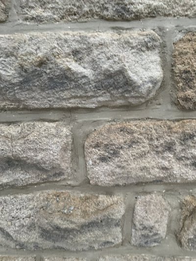

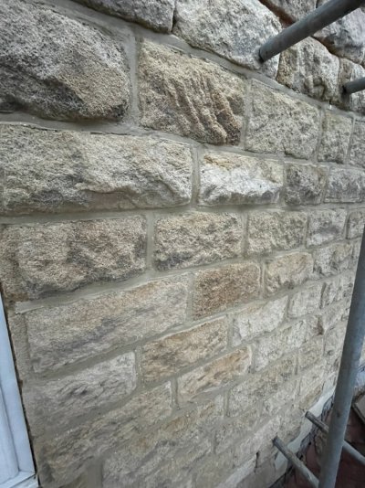

Hey there! So, I recently started working on pointing some lime mortar for a 200-year-old grit sandstone house. The guys I hired showed up with a bag of blue circle hydrated lime. They're mixing it with river sand and builders sand, nothing else. I have to admit, I'm not entirely sure if this is the right kind of lime for the job. But when I questioned them about it, they insisted that it was. However, now that I'm looking at it today, the mortar seems very white and brittle, with lots of hairline cracks appearing. It's not at all like the lime mortar I'm used to using. Do you have any advice for me? I'd really appreciate your input!
