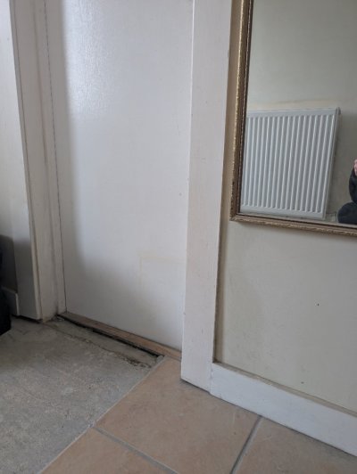

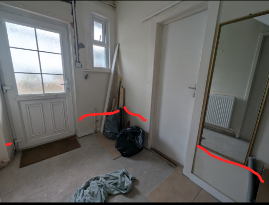

There is damp everywhere. The red lines are showing the walls where we have damp... You will also see the water mark under the mirror in the hall.
It is assumed there is no DPC anywhere in the walls.

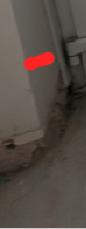

There is a DPM under the screed in the hallway. This doesn't meet the walls (see photo with the green arrows showing where the DPM ends).
There is no DPM in the garage. The wall between hall and garage is soaking wet. In fact, every wall in the garage is soaking wet.
We don't see any other option that using DPC injections to fix the rising damp - Thoughts please??
