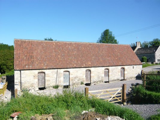

Hi , I'm converting a grade 2 listed stable block and have come up against a building regs issue.
I intend to use limecrete flooring as the building has no DPC but find we are in an area that requires us to provide basic protection from radon. The risk of radon is stated as being 5% or less but the council is insisting we need to use a radon barrier unless we can provide a credible alternative solution. Any ideas??
We contacted bre and had suggested installing a radon sump with an extraction fan under limecrete without a radon barrier but no one is willing to put this down on paper to appease building control...has anyone else heard of this method being sucessfully deployed? Is it possible to test for radon in an unsealed and unoccupied building with clay floors? as I'm willing to bet that our 95% odds of not having a radon problem will be bourne out thus solving that particular issue

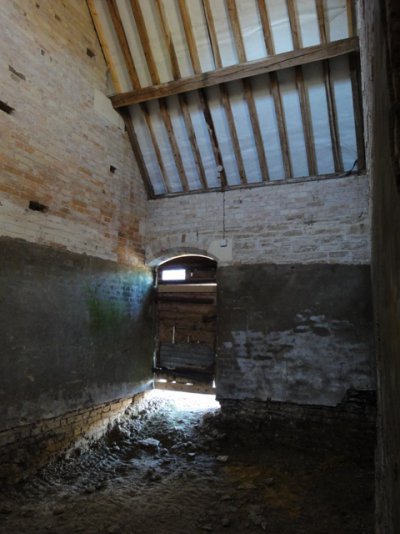

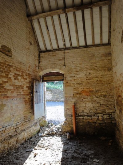

Furthermore just to add to things the BCO has stated that " Also as a result of not providing a Damp Proof Membrane there would be no protection against damp penetration from the ground." even though the conservation officer has talked them through the theory of how limecrete works in old buildings. It's just not a concept that fits within their guidelines.
The stables have several internal tudor brick and lime mortar partitions with no DPC so even if we put a radon barrier in it would be almost impossible to seal it against these walls so would in my view be a complete waste of time and detrimental to the fabric of the building as it would push any ground moisture into the walls. What the council want us to do is to put in a dpc and tank all the walls to 1m above floor level and put in a concrete foundation...it's exasparating!
All suggestions welcome
