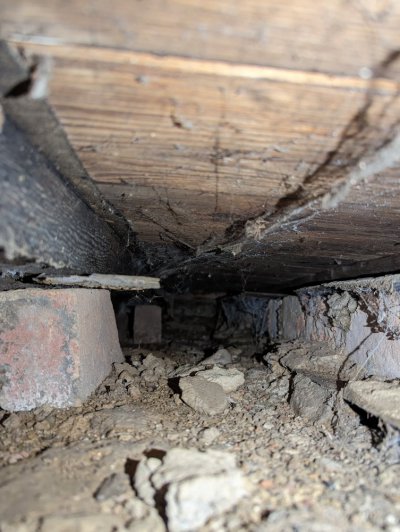

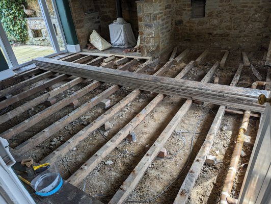

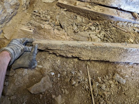

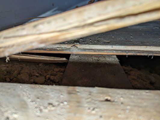

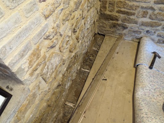

I took some floorboards up to see the situation. The floor joists are basically set into bare soil, so only a very small air gap of 2 inches under the floorboards. In other areas there's no gap at all and the boards are streight onto soil.
There is no evidence of damp soil thankfully.
There are only 2 low-profile air bricks on only one side of the 30m2 room.
How can I tackle the radon issue cost effectively? I would get a specialist but the radon industry is full of cowboys.
I'm very concerned about digging down because the floor is barely above ground level. On one side of the house I had to dig out a french drain for this reason. So, I'm afraid of exposing moisture which then cannot ventilate away easily.
I'm also concerned because this part of the house has no footings for its 2ft thick walls.
