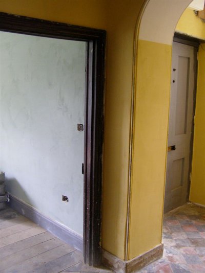

We've been living here more than three years now, and I still have jobs left over from before we moved in. Today I finished another of these, and Jane is very happy with the result so I can feel quite smug.
The hall and lounge both have a wooden corner bead at each vertical right angle; this photo shows the hall as it was after the initial plastering and decoration:
The original feature was to maximise the amount of the visible wood by having a chamfer at the edge of the plaster instead of plastering flat up to the wood in which case you would only see a very small amount of wood. The chamfer allowed perhaps even half of the wood to be seen; of course at some time someone had papered the walls and covered all the wood!
My plasterer found the chamfer difficult although at each one he did make some sort of effort. As ever, there was no time to sort it before we moved in, so it has waited for my attention until this summer. Back in March I removed the paper and cleaned up the wood. Then I cut back the plaster to give a rough 45 degree chamfer on each side, and then in June I plastered these chamfers to make them smoother; finally today I applied the limewash to each of the four corners in the lounge (two for the window bay and two for the chimney breast), as well as limewashing various bits left unrepaired after the fitment of the new window in June 2011.
I'm very pleased that the limewash has dried to match the earlier stuff so you can hardly see the new application. Overall a messy job but well worth it. Now I just have to do the same to the ones in the hall!
