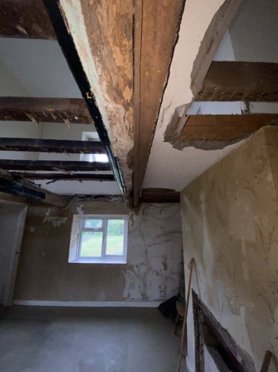

Hello everyone,
I’m new to the forum and this is my first post. My name is Kenny and I’ve recently purchased an old cottage near Bristol which is estimated to be around 150 years old. It’s been interesting reading through past posts and I am hoping that someone will be able to help me with some advice on our next steps. I’ve included a few photos for reference.
The property is not listed and had been used for social housing for the last 60 years where the tenants undoubtedly loved living there but the maintenance of the property was the responsibility of the housing association who did little to care for, or preserve the character of the property.
As a result the property has been affected with damp and woodworm of sorts. This was identified during the survey but the extent of the damage wasn’t known until the sale was completed and we started investigating. There is evidence of woodworm throughout the property although this could be historic as there is no obvious signs of it still being active. There have been remedial repairs over time, none of which seem to be sympathetic to the property.
The first floor is composed of several large beams which span a 4m gap (1). All of the timbers which run adjacent to these beams have damage from woodworm, with the most severely affected being almost hollowed out (2). I had hoped that the extent of the repairs might be to replace these timbers but I fear that may have been naively optimistic as where the large beams meet the walls there is more notable damage (3) and one of these beams has been sistered with a modern floor joist (4).
I have had a local builder round who suggested replacing the floor structure with RSJs and modern floor joists but before considering this further, I’d like to explore the possibility of repairing & trying to retain what character is left.
I’d welcome any advice, or if anyone can recommend an appropriate tradesman in the South West of England who could undertake an assessment and the work that might be required?
Thanks for taking the time to read this.
Kenny
