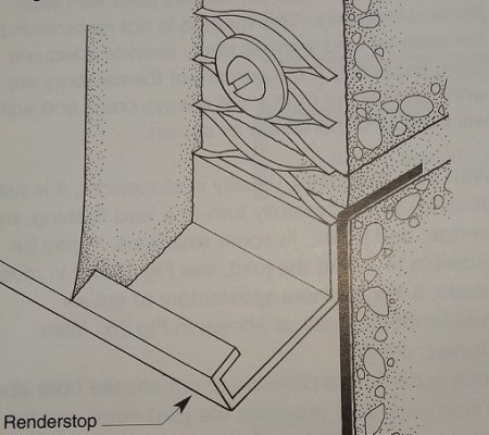

I would like advice on how I should go about fitting flashing to cobble/stone walls. I have recently re slated the roof over our kitchen which sits in between two irregular cobble/stone walls. I've done soakers under each course but to complete am at a loss as to how to do the flashing. I can't do step flashing as the stones are not regular. I don't want to lime mortar over the lead as I think the mortar would crack and fall off and I don't want to cut a groove in the wall to fit a flap of lead into...
I'll post photos of the wall shortly
Can any one help
Can any one help
