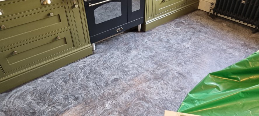

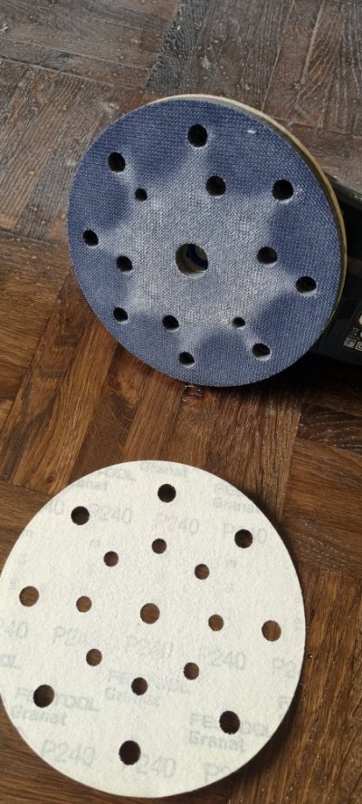

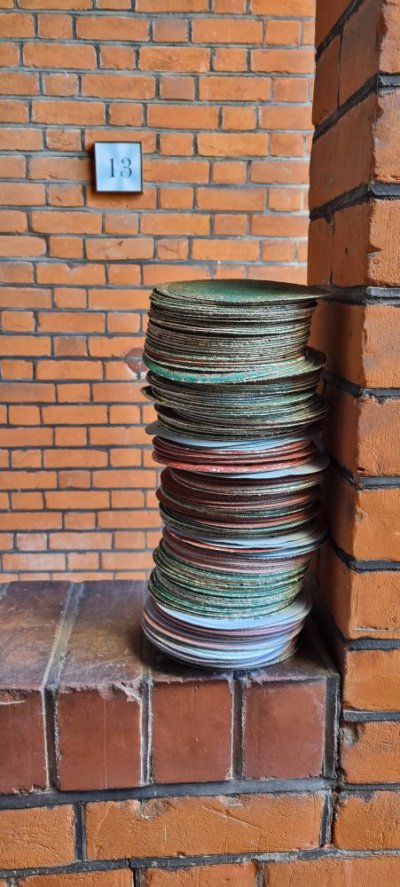

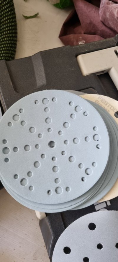

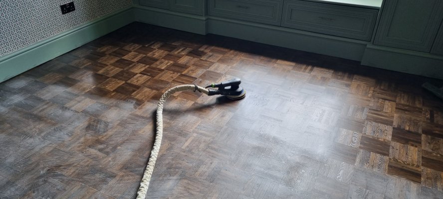

Todays abrasive is Festool Granat P240. Granat is a sintered ceramic alumina, after P120 it's a greater percentage regular alumina so quite soft but still with a little bite.
These discs are great for intercoat sanding where you need to denib but don't want to burn (break through) the finish.

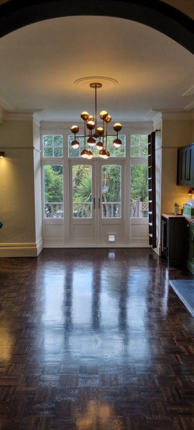

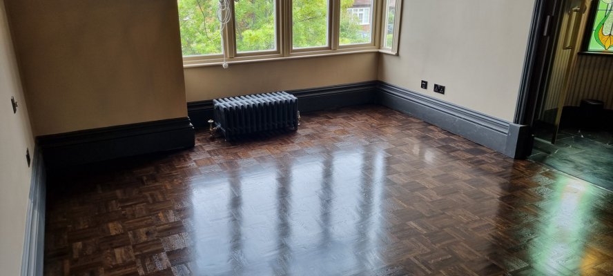

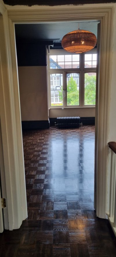

Here they are being used on Bona Traffic HD penultimate coat.

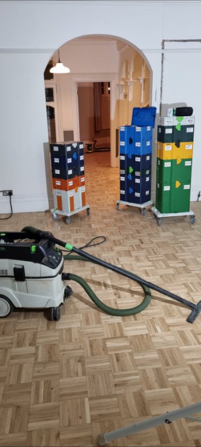

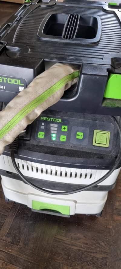

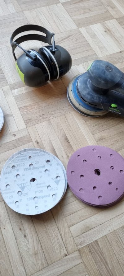

The sander is Festool ETSEC150/3 the finest sander out there. Remember to use a thick interface pad and turn your extractor down to low so the suction doesn't stop the pad rotating freely.
