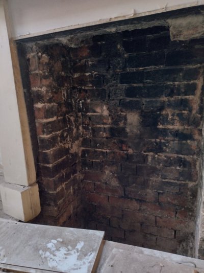

The 1st and and 2nd floor of the property has disused fireplaces - Will the hollow rectangular box need to be bricked up and the open space which leads to the chimney blocked with some sort of chimney balloon to prevent cold draughts entering the rooms.

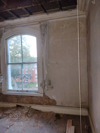

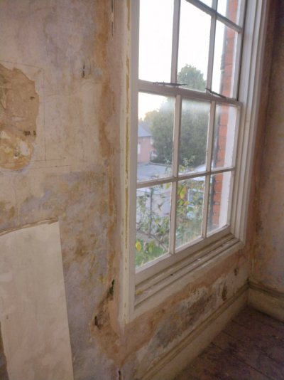

There some tricky areas to be insulated- space adjacent to window frames and arched spaces above sash windows. I'm having difficulty visualising the end result- any insulation will sit proud of window frames.

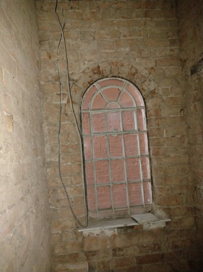

There are 2 identical windows like these in the pantry with superior brickwork inclined inwards towards the top arch. Again i'm having difficulty appreciating how the perimeter of the windows will be insulated

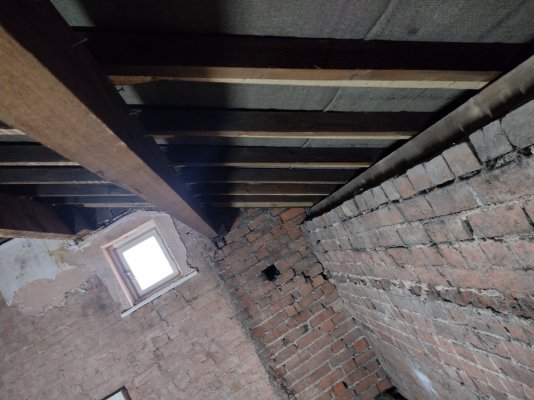

2) Insulation at rafter levels sloped roof: Im thinking of attaching PIR type foil backed insulated plasterboards to the rafters an sealing any gaps between the boards or gaps between the wall insulation/wall and the boards with proclima type. Will leave plentiful gap (>50mm between the insulation and bitumen felt to allow for ventilation.
The whole in the wall to the lower right hand iside of the window - has that intentionally been left for ventilation?
Previously the space between the purlin and the brick wall was a residual loft space. The partition from the purlin to the floor has been removed to create extra room space. I'm hoping there is no danger in this approach of introducing unintended consequences.

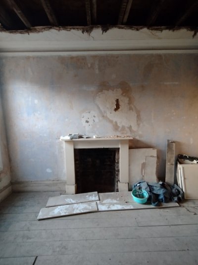

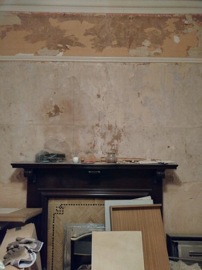

3) There are damp patch areas close to the fireplaces in a number of the rooms. I suspect these may be due to the fact that chimneys are open topped. I think I will need to place chimney caps to eliminate rainwater flow down the chimney. Alternatively these may be due to build of hydrocsopic salts near the chimney breasts?
What is your opinion on these damp patches and importantly on the solutions.

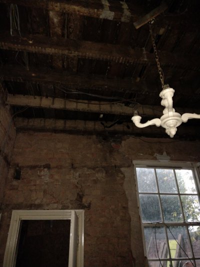

4) Downstairs living room- the height to ceiling is I think about 3.2 or 3.4 m. Would you consider adding dropping the ceiling height to say about 2.7m to just above the top of the window frame by adding more joists rather than lowering joists.
Main rationale for dropping ceiling would be to conserve heat in the living rooms. Is this a sensible approach?
