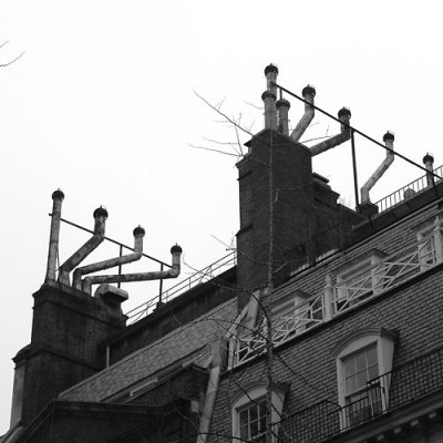

I'm a bit puzzled by the fact that we have 5 pots on our largest chimney, but have only got four fireplaces that we know of. Downstairs, there's the kitchen which is currently housing a boiler- so I know which one that is: the gas cowl is sitting in the space of an old clay pot, parts of which surround it, i.e it hasn't been shoehorned in.
In the dining room on the other side of the chimney there is a 1980's Rayburn, that's another flue explained (although why there is a cooker in the dining room is not). Then upstairs there are two bedrooms, with one fireplace each.
I'm thinking/hoping that there is something interesting to find downstairs. Both fireplaces have been tiled over so until we start renovating we can't see what is happening with the brickwork. Would it be common to have more than one flue in a room (late Vic/early Edwardian)? The space the Rayburn is in isn't quite inglenook territory but must be 5-6 feet. Two stoves in the kitchen perhaps?
