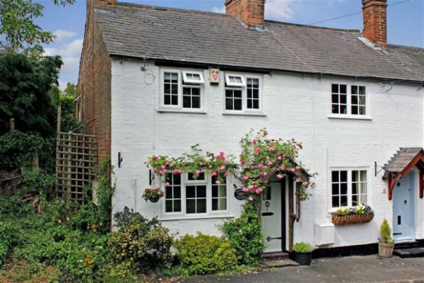

Hi Everyone,
This is my first post here and I have spent weeks reading through your wealth of knowledge after having experienced the usual round of surveyor says damp, damp and timber company survey quote ridiculous amounts for horrid chemical DPC, mortgage company retain funds until work done nonsense, whilst attempting to buy our lovely cottage.
Thankfully following your advice, my husband and I hired an independent surveyor who said that no such work was needed, but he did find localised damp which looks like condensation in a few spots and some quite bad areas of damp and wet rot under the stairs which is very poorly ventilated. Thankfully the mortgage company have accepted this with no retention! We are hoping to complete by the end of the month.
My husband and I have very much fallen in love with our cottage and want to do the very best by it. Sadly the poor house has already been DPC injected, tanked and UPVC double glazed to within an inch of it's life
The wet rot and damp under the stairs really needs attending to urgently and I suspect are caused by the walls either side having been injected, concentrating all the moisture into one area. My feeling is ventilate, dry out replace timbers, open the chimneys and dig out the raised ground levels to the end of the house - see picture - as a start!
BUT my fear is that as the whole house has been injected already, it's breathability may have been so disturbed that it may not recover. It is not rendered but has certainly been painted. The external ground levels are up to 3' higher than the internal floor in places and the land belongs to neighbour so no guarantee they will let us dig it out, although currently it's not used -so fingers crossed. That wall is dry though (tanked), the problem wall is the other side of the house. It is totally against my instinct to inject the small area under the stairs, but given that it's the ONLY bit of the house that has not been done, is it realistically our only option now? Or is there always hope even with such damage inflicted? Surprisingly, most of the house inside is very dry and totally livable whilst we sort out issues
So sorry for the long post and hoping that I don't sound like a duffer!
Helen
