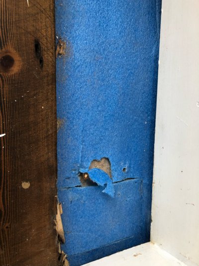

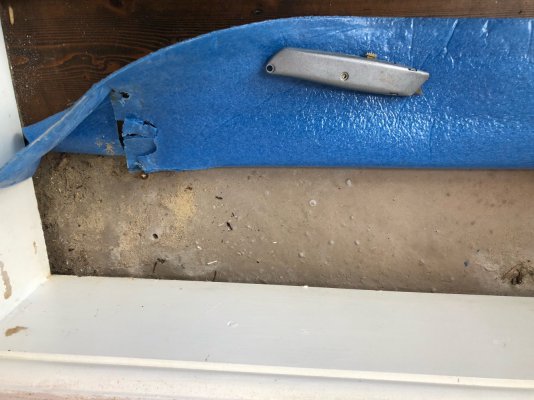

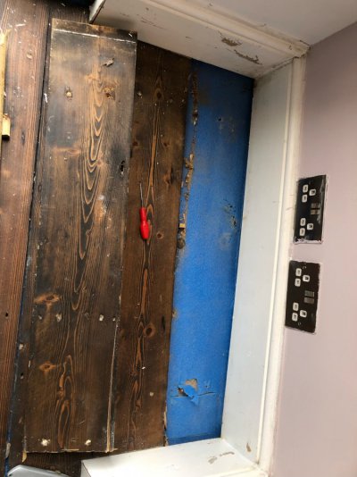

Today I have removed a board in the corner. The boards have been screwed down directly into the concrete, with a blue foam underlay. In some places there is a very small gap between the bottom of the board and the underlay, a few mm max.
I was surprised that it wasn't actually moist at all under here, and there wasn't much sign of worm holes underneath.
